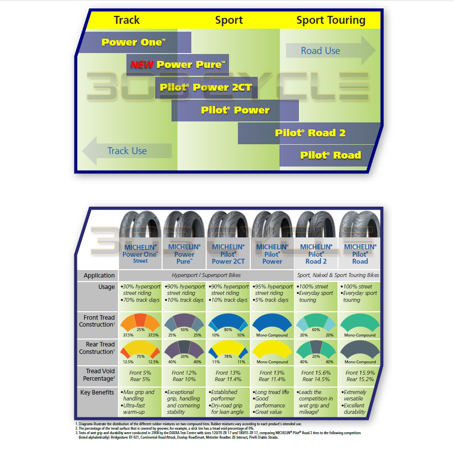

here is a cool chart to get some ideas what Michelin has to offer
You can apply the basic ideas shown here for other tire brands as well
My personal favorites recently is the Pures
