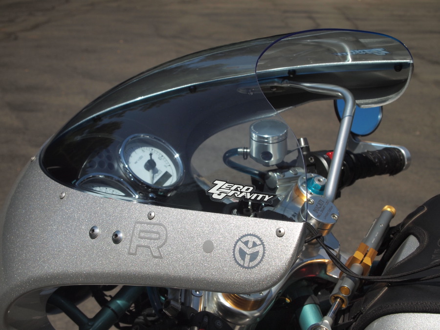

It is really the premium parts they put on
We have the Ohlins catridge kit to make the showa forks Ohlins internals
or wait for the Ohlins forks we are coming out with in Black or Gold
and the DU707 rear Shock make a pretty big difference
Springs rated to your riding weight and Spring color available in Black or Yellow
The Ohlins Steering damper is a remarkable upgrade from stock damper
Other then that
wheels, brake caliper/rotor/pump upgrade
Rear brake conversion upgrade

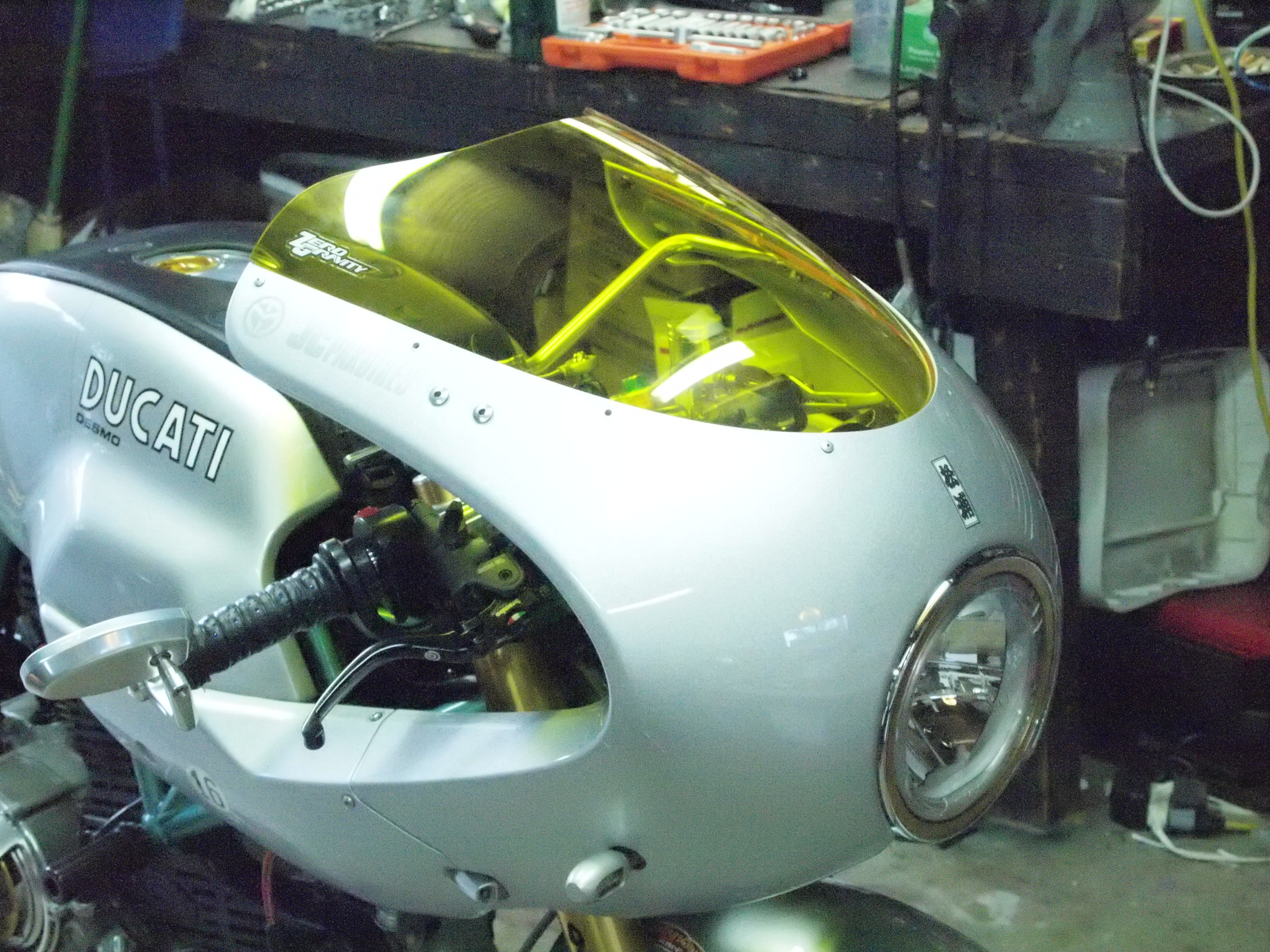

Tinted screens
Yellow
Blue
Bar end mirrors
on and on we go
