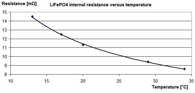

I've been running a couple threads on my experience of changing my OEM battery for a smaller Li Ion unit - as it's not been as straightforward as I'd hoped and expected.
I'm still heaving a few teething problems. After failing to make the bike work with three small units wired in series I upgraded to a single larger unit, but this seems to suffer from the cold and more than a few days being drained by the ECU - so it seems I need quick release connectors so I can take it inside on cold days, and probably an isolator switch so there's no drain at all if I leave it several days.

In summary, I am now running a RB2400 from Racing Batteries. It works very well when both the battery and the bike are warm, but when the battery is warm and the bike is cold (battery kept indoors) I have to twist the throttle to make it turnover, so it coughs into life (albeit very easily) - which I am concerned may not be all that good for the engine?
Here are the pics:
When both the bike and battery are below about 3 degrees celcius the bike will eventually start, but only moments before you give up, (I'm guessing the battery self-warms through failed attempts) and only then with a carefully timed twist of the throttle.

I'm also gonna re-post this reply to cold issues mentioned in my first thread, as it's very useful to a general battery thread:
Originally Posted by Kookz View Post
It's the cold, the cold, and only the cold. I have a quick disconnect on my battery and pull it out if I'm parking the bike outside in the cold. Throw the battery in my helmet or pocket, and I'm all set.
