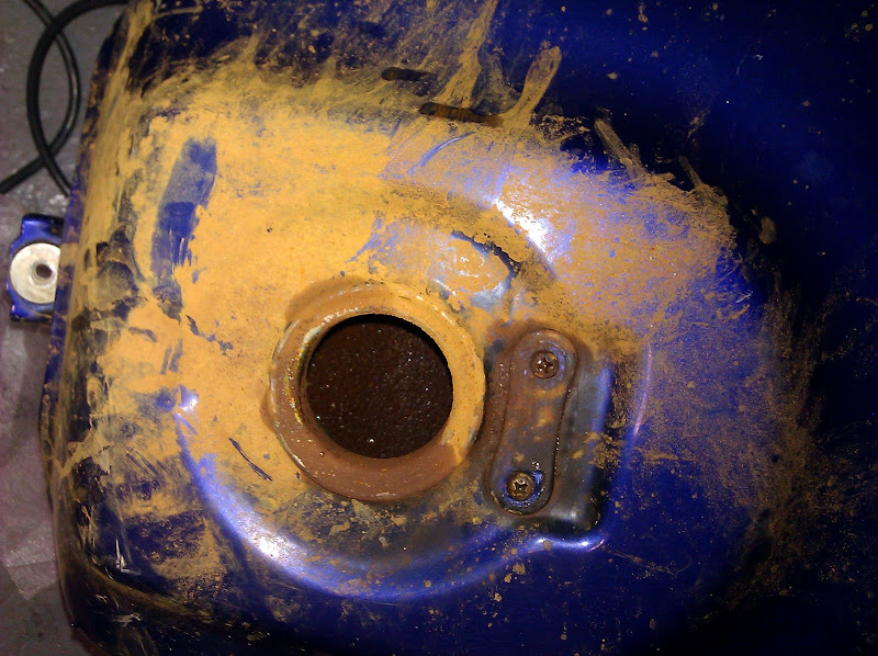

If all you want is ti remove rust use Metal Rescue, 1 gallon jug cost $25, works wonders and does NOT damage paint
went from this
to this (have lots of rusty tanks so I got 5 gallons for $90)
